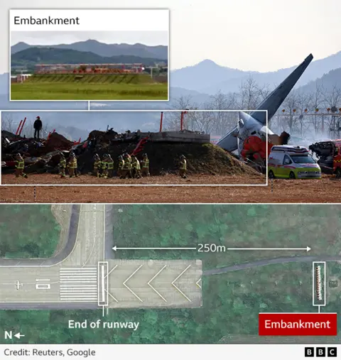

    Aviation experts have raised questions about an “unusual” concrete wall near the runway and its role in the South Korea plane crash that killed 179 people.

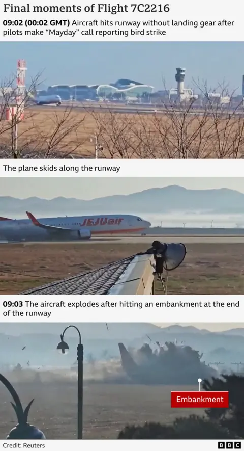

    Footage shows the Jeju Air plane coming off the runway before colliding with the wall and bursting into flames at Muan International Airport on Sunday.
    Authorities investigating the cause of South Korea’s worst-ever plane crash are considering the significance of the concrete wall’s location about 250m (820ft) off the end of the runway.
    Air safety expert David Learmount said that, had the “obstruction” not been there, the plane “would have come to rest with most – possibly all – those on board still alive”.

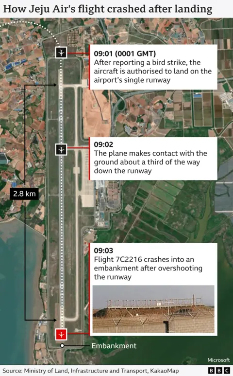

    The pilot reported that the plane had struck a bird and then aborted the original landing and requested permission to land from the opposite direction.
    The plane came down some distance along the 2,800m runway and appeared to land without using its wheels or any other landing gear.
    Mr Learmount said the landing was “as good as a flapless/gearless touchdown could be: wings level, nose not too high to avoid breaking the tail” and the plane had not sustained substantial damage as it slid along the runway.
    “The reason so many people died was not the landing as such, but the fact that the aircraft collided with a very hard obstruction just beyond the runway end,” he said.

    Another aviation analyst agreed. Captain Ross Aimer, chief executive of Aero Consulting Experts, told Reuters news agency: “Unfortunately, that thing was the reason that everybody got killed, because they literally hit a concrete structure. It shouldn’t have been there.”
    Christian Beckert, a Lufthansa pilot based in Munich, called the concrete structure “unusual”, saying: “Normally, on an airport with a runway at the end, you don’t have a wall.”
    The concrete structure holds a navigation system that assists aircraft landings – known as a localiser – according to South Korea’s Yonhap News Agency.
    At 4m high, it is covered with dirt and was raised to keep the localiser level with the runway to ensure it functions properly, Yonhap reported.
    South Korea’s transport ministry has said that other airports in the country and some overseas have the equipment installed with concrete structures. However officials will examine whether it should have been made with lighter materials that would break more easily upon impact.

    A graphic showing a timeline of the plane crash, from when the plane was authorised to land at 09:01 local time after reporting a bird strike, the landing of the plane on the runway at 09:02 and the plane crashing at 09:03 after overshooting the runway

    However former pilot John Cox, chief executive of Safety Operating Systems, said the runway design “absolutely (did) not” meet industry best practices, which preclude any hard structure within at least 300m (984ft) of the end of the runway.
    Following the crash, it emerged that remarks in Muan International Airport’s operating manual, uploaded early in 2024, said the concrete embankment was too close to the end of the runway.
    The document, prepared by Korea Airports Corp, recommended the location of the equipment be reviewed during a planned expansion.
    South Korea’s director-general for airport policy, Kim Hong-rak, said the government would “review the relevant regulations and their application”.

    A composite image with photos showing the embankment off the end of the runway at Muan International Airport, the wreckage of the plane that crashed, and a graphic showing the runway and the 250-metre distance to the embankment.
