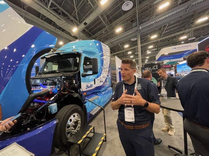

In actual use, Williams said the hydrogen engine is very similar in overall performance to today’s compressed natural gas-powered engines. And using that knowledge, the SwRI team has worked with automated transmission calibrations and other settings to make the hydrogen engine feel more like a diesel vehicle with similar performance characteristics.
Ryan Williams, spark-ignited engine research and development for SwRI talks about liquid-hydrogen ICE technology at ACT Expo 2024.
