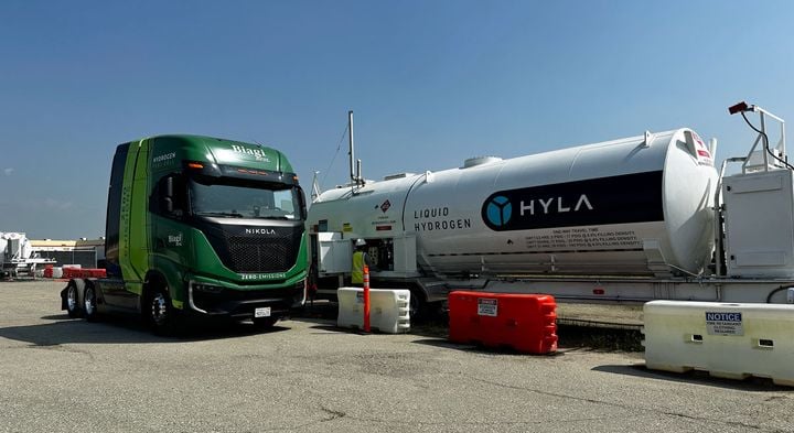

Biago Bros. was one of the fleets on hand for the opening ceremony of Nikola’s hydrogen fueling station.
Nikola’s Hyla energy brand is using modular hydrogen refueling stations to help bridge the chicken-and-egg gap between supply and demand for fuel-cell-electric trucks.
Hyla, announced in early 2023, is a brand devoted to procuring, producing, distributing and dispensing hydrogen to fuel its zero-emissions trucks — and those of other truck makers.

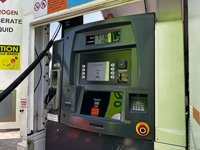

In February, Nikola opened its first high-pressure hydrogen refueling station. Located in Ontario, California, it’s right across from the Ontario airport. Flying in to that airport, you can see a carpet of warehouses and distribution centers surrounded by trailers and trucks, a market for zero-emission trucks as state mandates kick into gear.
The modular station will be capable of fueling up to 40 Nikola FCEV Class 8 trucks daily. It’s part of Nikola’s plan to develop up to nine refueling solutions set to be completed by mid-2024, with 14 total refueling solutions to be operational by the end of the year.

The Ontario station will be capable of fueling up to 40 Nikola hydrogen fuel cell electric Class 8 trucks daily.

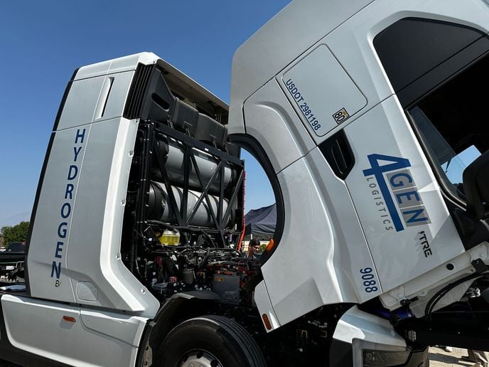

4 Gen Logistics is one of the fleets looking at incorporating fuel-cell-electric trucks.
