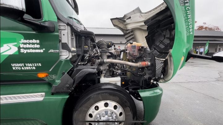

Cummins reports that its Jacobs cyinder deactivation system boosts heavy truck fuel economy by almost 3% in on-highway testing.
Cummins Valvetrain Technologies reports positive results from further on-road testing of its Jacobs cylinder deactivation (CDA) technology. CDA for diesel engines is a new powertrain technology. Cummins said its goal with CDA is to improve the environmental and economic performance of heavy-duty road vehicles.
Cummins says fuel savings of 2.76 percent were returned in the first SAE J1321 (Society of Automotive Engineers) standardized fuel consumption testing of Jacobs CDA. The test used fully loaded comparison trucks on a highway route in North America.
Similar tests on a distribution route returned fuel savings of two percent.

The tests were conducted using a 2018 International LT625 6×4 tractor unit. The truck was spec’d with a 13-liter Navistar A26 450 hp diesel engine and Eaton Endurant 12-speed overdrive AMT gearbox, with a gross vehicle weight of 66,000lbs.
Tests were conducted over 12,000 miles in Q4 of last year according to the SAE J1321 standard fuel economy protocol.
The truck was run multiple times both with and without CDA active via a dashboard switch. The truck recorded an average speed of 51 mph on the highway route, and 38 mph on the distribution route.
Every run saw the test truck accompanied by a comparable control vehicle with its fuel consumption also recorded, to provide a baseline to account for variations caused by external factors such as weather and traffic conditions.
