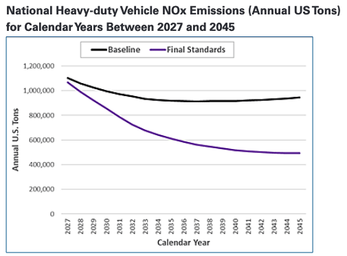

EPA projects that by 2045, this final rule will reduce NOx emissions from the in-use fleet of heavy-duty trucks by almost 50%.
EPA projects that by 2045, this rule will reduce NOx emissions from the in-use fleet of heavy-duty trucks by almost 50%.
