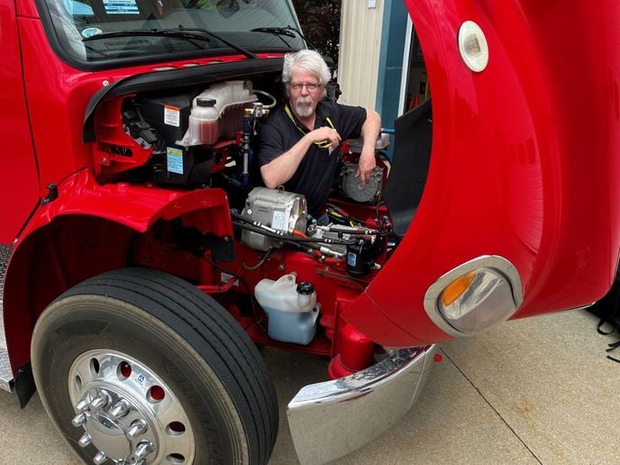

A high level of electronic integration and modular design reduces the parts count from 145 to 69, freeing up previously occupied chassis real estate and space under the hood. (the author is standing in the engine compartment between the frame rails with both feet planted firmly on the ground).

Webb noted that integration can yield a weight reduction of about 50% compared to a typical first-generation Class 7 EV chassis while reducing the parts count from 145 to 69. This would include significant reductions in high-voltage cable, connectors, coolant lines and fittings, components and component mounts while freeing up previously occupied chassis real estate and space under the hood.

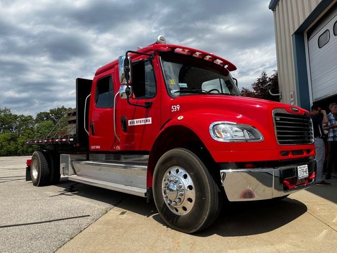

BAE Systems and Eaton unveiled this demonstration truck at the Marshall Proving Grounds in June. It combines BAE’s suite of power dense, advanced power electronics with Eaton’s MD 4-speed EV transmission to provide a full heavy-duty EV system.

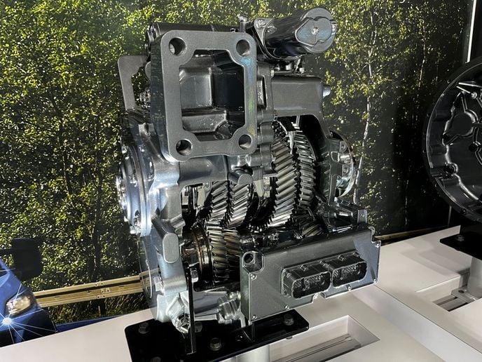

Eaton’s MD 4-speed automated manual EV transmission improves startability and gradability while improving energy efficiency at highway speeds.
