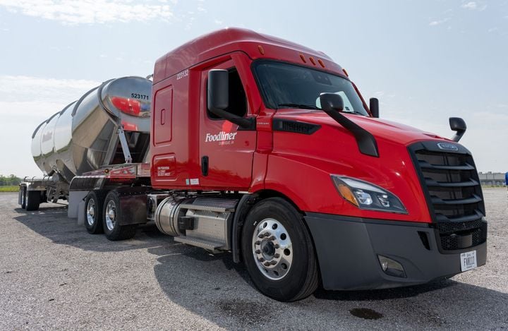

Working with suppliers, Neumann has driven a number of innovative features to address safety, quality, driver comfort, and longevity.
“One of the problems we have with food-grade trailers is you’re always up on top of the trailer,” he explains. But the non-slip material they were using didn’t work that well and wouldn’t stay put.
After experimenting with different options, he and his team landed on an aluminum nonslip material that could be welded to the top of the trailers. It reduced the risk of someone slipping and falling and it eliminated the need to replace nonslip tape.
“We had a concern about, sooner or later, some of that nonslip material is going to go into the vessel,” he adds. “And I don’t know about you, but I don’t want to eat nonslip material.”
It worked so well that MAC, Polar and Heil trailers added it as a databook option.
Another challenge is making sure rodents or insects don’t get into the trailers and contaminate the load. Years ago, he worked with BTI (Bulk Tank Inc.) to create the Critter Stopper valve, which keeps these “critters” from entering a bulk tank trailer through the blow-down exhaust pipe.
Over the last two years he has worked with BTI to help design the second generation of the Critter Stopper, making it even better.
The device is a spring-loaded flap that attaches to the end of the blow-down line and remains closed when not in operation. It allows the internal air pressure in the tank to be emptied after the unloading process while not allowing anything to enter back through the blow-down line, “to make sure that [the load] stayed food grade even when it was sitting in the parking lot.”
Again, it worked so well that BTI started selling the Critter Stopper to other fleets.
