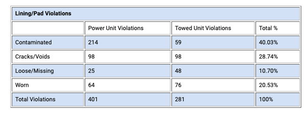

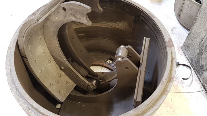

Top Brake Lining/Pad Violations
This year, emphasis was placed on brake lining/pad health and safety. Inspectors found 108 power units and 66 towed units with lining/pad violations.
A total of 114 brake lining/pad violations were discovered on power units. The top brake lining/pad violation on power units was for contamination, with 48 violations.
2024 Brake Safety Day data related to brake linings/pads
Seventy-one brake lining/pad violations were identified on towed units. Twenty-three of the violations were for cracks/voids in the linings/pads, which was the top brake lining/pad violation on towed units.

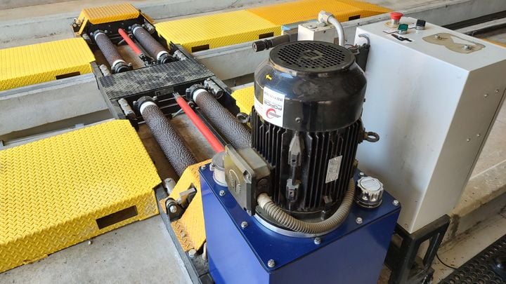

Performance-Based Brake Testers
Nine U.S. jurisdictions with performance-based brake testers (PBBT) used them during Brake Safety Day.
A PBBT is a machine that assesses the braking performance of a vehicle. Federal Motor Carrier Safety Regulations and CVSA’s North American Standard Out-of-Service Criteria require a minimum braking efficiency of 43.5%. If the vehicle’s braking efficiency is below that, it’s not providing the minimum stopping power required and needs to be serviced.
Eighty-eight PBBT inspections were conducted on Brake Safety Day. Four (4.5%) failed to meet the 43.5% minimum braking efficiency required and were placed out of service.
