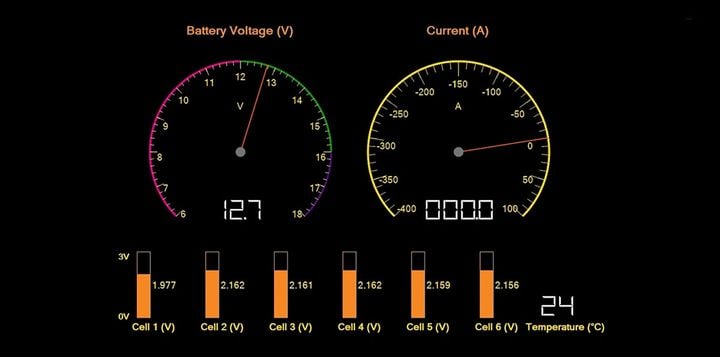

The screen displaying battery information is simple and intuitive to use. Two large gauges at the top display the battery’s overall voltage rating and current in amps. Below, each two-volt cell is displayed as a bar graph, with the cell’s current voltage to the right and a colored graph showing how much life is left in each cell. Healthy cells will be colored green, aging cell graphs colored yellow, and cells in danger of failure colored red. Technicians can access the system during vehicle maintenance to check battery life and replace one if a failure is predicted before the next service interval.
