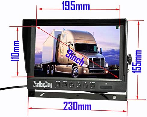

9″ IPS DVR Recorder Monitor
Display Size: 9 Inch Large Screen
Power requirement:DC 12V-24V
Consumption:8W
Video:2 CH Split Screen
