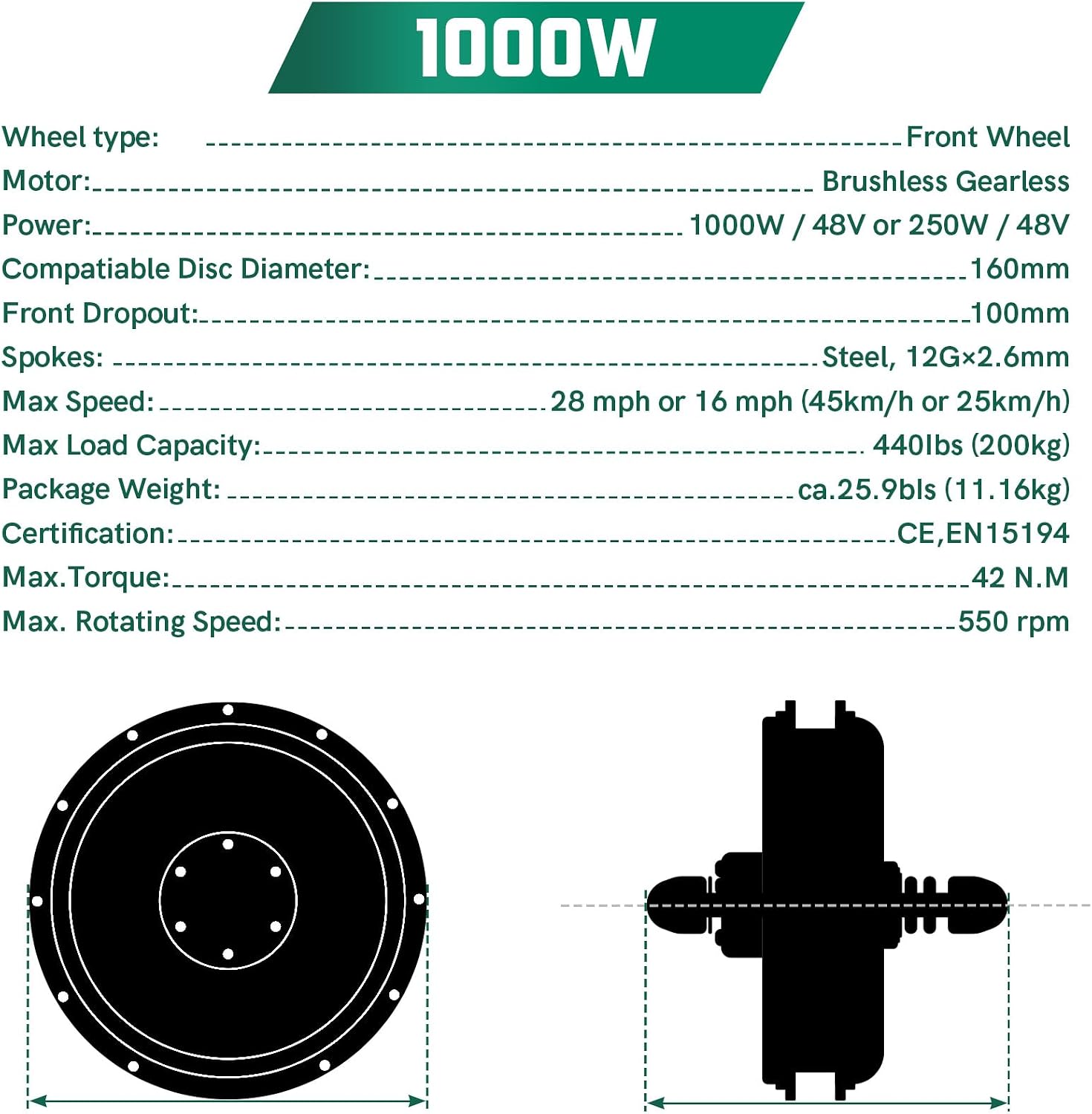

The Electric Bicycle Kit Key feature
* 48V 1000W and 750W super power brushless gearless hub motor
* Nylon tire & alloy rim & stainless steel spoke
* Rare-earth metal magnet are used in the motor to efficiently produce large power
* Aluminum alloy powerful controller supports big current supply
* Adjustable 5 level intelligent pedal assist with twist throttle
* LCD display shows battery level and pedal assistance settings
* Brake Levers cut off the power supply to the motor safely
* Crank speed sensor for pedal assist
Upgraded Intelligent Motor Controller:
* Allow you to swap two power modes between the full 1000W power or 750W power by a single blue switch wire is embedded in controller. (Only for Twist Throttle)
* Still remain the full 1000W power with no speed control.(Only for Pedal Assist System,”PAS”)
Specification:
Wheel type: Brushless gearless Front Hub Motor 26 inch Wheel
Tire: 26 X 1.95″ Nylon
Rim: Alloy double wall Torque: 45 N.M
Spokes: Steel, 12G x 2.6mm
Wheel Axle: Length 210mm x Dia10mm
Max load capacity: 330-440lb / 150-200kg
Net weight: 22lb / 10kg
Mode 1 Power: 750W / 48V; Max speed: 24mph / 38 km/h
Mode 2 Power: 1000W / 48V; Max speed: 28mph / 45 km/h
