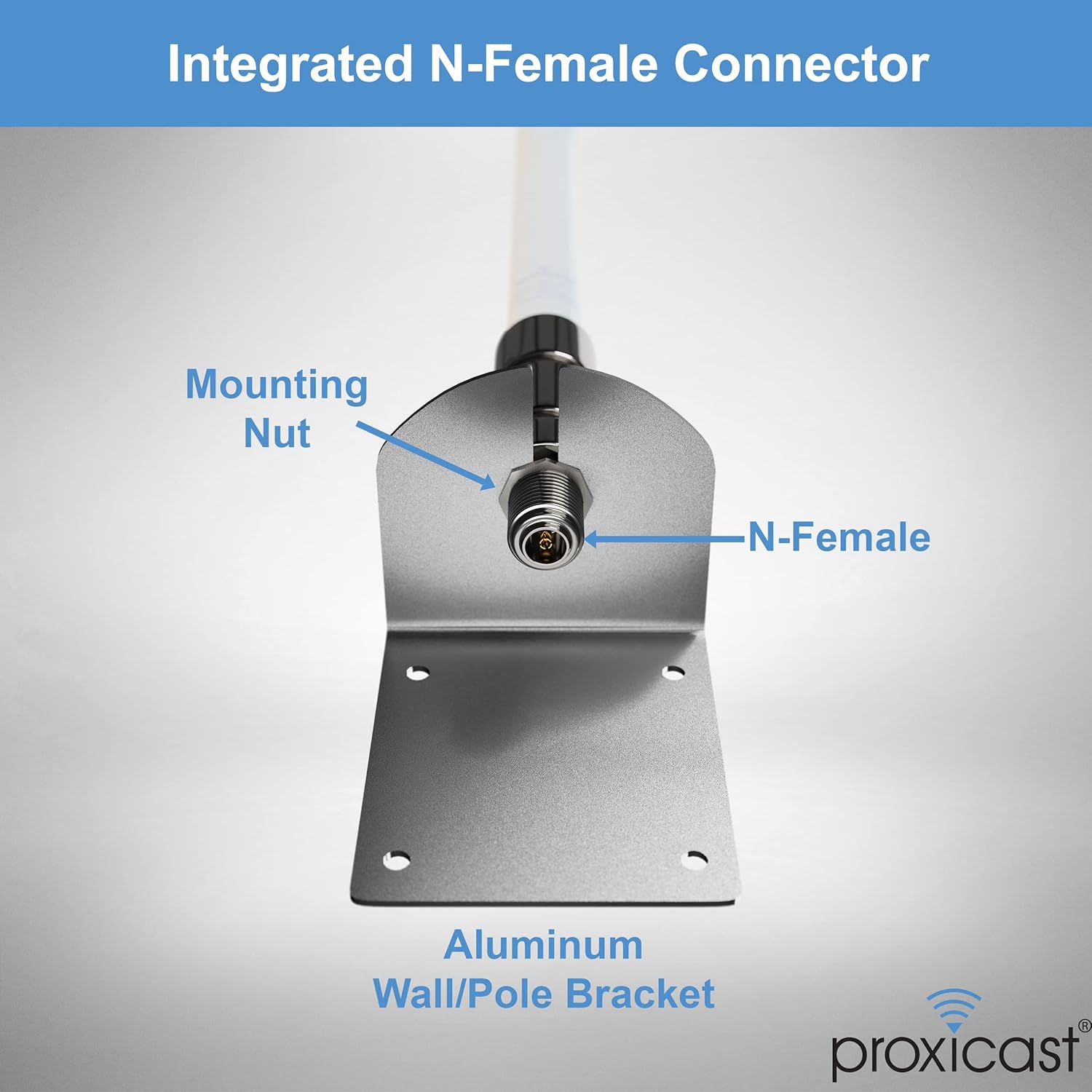

Key Features 10 dBi Peak Gain 600-6000 MHz Coverage N-Female Jack 24″ Tall Outdoor Rated – IP67 Pole/Wall Mountable Professional Grade
Specifications
Frequency Range: 600 – 6000 MHz (4G / 5G / WiFi / CBRS / FirstNet / LoRa / Helium / 900 MHz) Peak Gain: 10 dBi Radiation Pattern: Omni-Directional Polarization: Vertical Impedance: 50 Ohms Connector: N Female – bottom integrated Material: Fiberglass, Stainless Steel & Aluminum – White poly-urethane coating Height: 23.6 inches (600 mm) Mount: Pole/wall (bracket and 2 inch diameter U-bolts included). For Marine Mounting use adapter BRK-114-FF.

INTEGRATED FEMALE N CONNECTOR – No Additional Ground Plane Needed
WEATHER RESISTANT Sleek High Gloss White Urethane and Fiberglass Finish Designed for Outdoor Antenna Installation. Includes 2-Way Pole/Wall Mounting Bracket and Hardware (mast sold separately)
