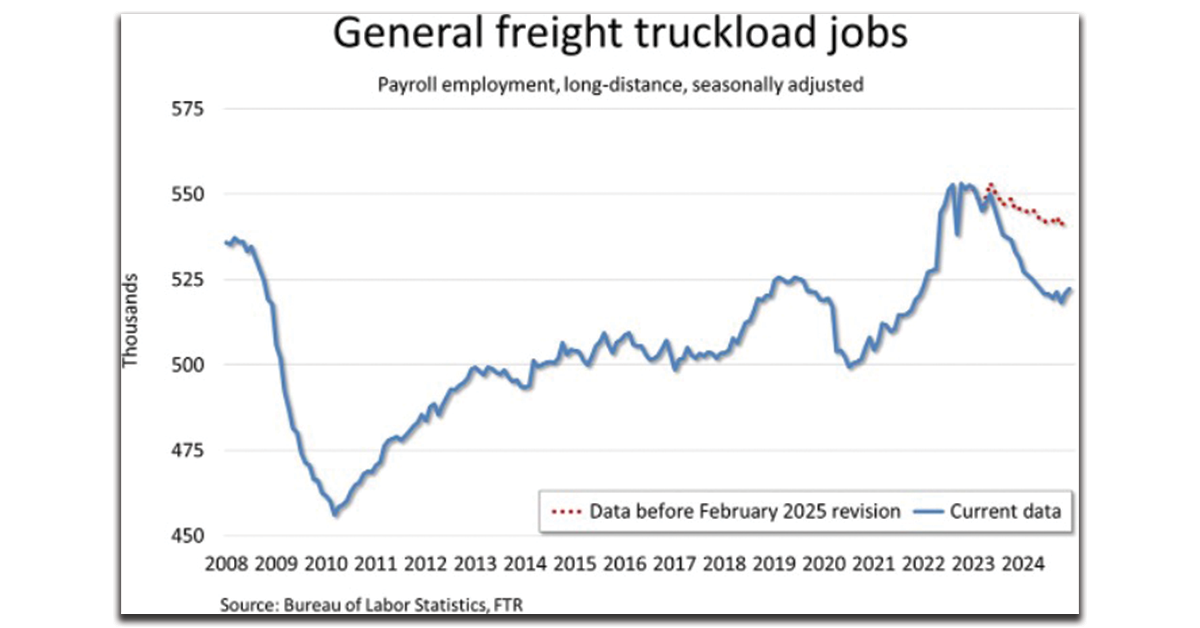

The benchmark revision for truck transportation shows 27,800 fewer jobs in December – the most recent month for which there is comparable data – than reported initially. Rather than being 1.7% above the pre-pandemic month of February 2020, the revised data shows trucking jobs at just 0.3% higher.
Significant revisions are not unusual. Last year’s benchmark revision for trucking was even larger at a reduction of 33,000 jobs. However, more than half of last year’s revision – 16,600 jobs – was in local general freight trucking. BLS showed only 6,000 fewer jobs for general freight truckload.
General-Freight-Truckload-Jobs-1200x628
The latest revision was a much bigger deal for truckload, however. BLS reduced its estimate for truckload by 22,200 payroll jobs, which is roughly what the preliminary data we reviewed in October suggested would be the case. The revision means that rather than being 4.3% higher than February 2020 levels, truckload payroll employment is up just 0.5% from that pre-pandemic month.
The speed of the truckload employment reduction is as remarkable as the size of the revision. In May 2023, seasonally adjusted payroll employment was just 3,000 jobs below the all-time high of 553,100 in October 2022. By June 2024, the seasonally adjusted level was 520,800, a drop of 29,300 jobs from May 2023. That’s a steep decline, although it is not as steep as the 38,100-job run-up over the same period of time leading to the October 2022 record.
The benchmark revisions for other trucking sectors were not as large but were significant. Local operations saw downward revisions of around 10,000 payroll jobs while LTL’s employment was revised higher by about 13,000 jobs. The smallest change among the major sectors was in long- distance specialized trucking, which saw an upward revision of just 1,300 jobs.

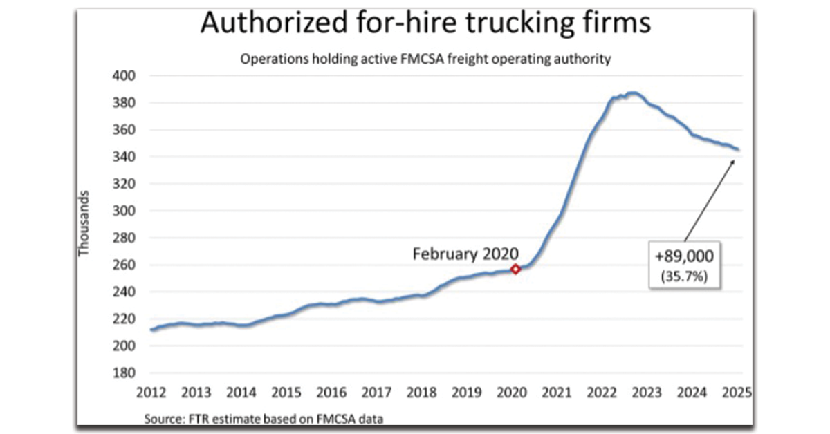

We have written and spoken dozens of times about this distortion and the factors that created it, so we won’t rehash that here. The bigger issue now is that the number of active trucking firms – a metric driven overwhelmingly by very small operations that largely are invisible to payroll employment tracking – has not dropped as rapidly as payroll employment has.
Authorized-For-Hire-Trucking-Firms-1200x628
Sure, the for-hire carrier population has dropped significantly from the peak in the fall of 2022 when the market had nearly 131,000 (about 51%) more carriers than it did in February 2020 immediately before the pandemic. The market still has around 89,000 (nearly 36%) more carriers than it did in February 2020, however. Payroll employment has virtually normalized; the carrier population has not.
No single issue accounts for this resilience. Some of it, no doubt, is due to the financial cushion afforded by extraordinary spot rates from mid-2020 through early 2022. According to Census Bureau data, non-employer trucking firms saw revenue growth of 8.6% in 2020 – a year in which employer firms saw a 0.7% decline in revenues.
Both groups had a great 2021, of course, although non-employer firms slightly outpaced employer firms with revenue growth of 20.7%, according to the Census Bureau data. In 2016, non-employer firms accounted for about 17% of total truck transportation revenues. By 2020, they represented about 20%. That share persisted at least through 2022, which is the latest year for which this data is available.

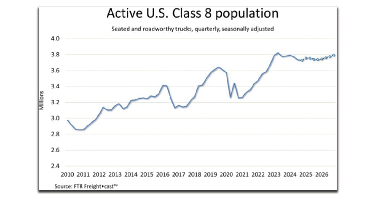

These factors, along with more stability in private fleet operations than in for-hire, gives us an active Class 8 population that is not much smaller than it was at the peak in 2023Q2, according to FTR’s reckoning. We estimate the population of Class 8 trucks with active drivers in 2024Q4 at only about 2.5% below that peak level, seasonally adjusted, with an expectation that the fourth quarter of 2024 represents the trough. FTR’s estimate is that active Class 8 capacity currently is close to 4.5% above the 2020Q1 level.
Our methodology for this estimate is wholly unrelated to data supplied to the Federal Motor Carrier Safety Administration by carriers themselves, but it doesn’t look much different from the pattern reflected in reports from for-hire carriers. FTR’s analysis of FMCSA registration data suggests that for-hire driver capacity bottomed out between July of last year and this January. However, carriers are required to report only every two years.
Acitve-US-Class-8-Population-1200x628
Therefore, a snapshot today of the data reported to FMCSA might not fully capture the drop in employment that occurred mostly during 2023. In any case, a bottoming out this fall would square with the pattern seen in payroll employment data.
